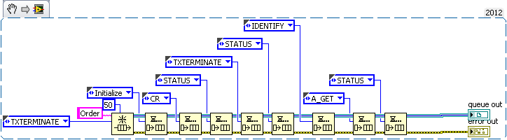

I am working on a queued state machine setup. I am using a type def with all of my possible states in it as the elements of my queue. At the start of my program the queue needs to initialize with a specific order as shown in the snippet below. However, when I run the code and probe the queue at the end, I end up with 0 entries in my queue. Am I missing something? This is my first time working with queues in labview.

Is another process dequeuing in parallel?  How are you checking to see how many items are in the queue?
Just as a convenience, it would be better to create an array of the tasks and enqueue inside of a FOR loop.  Be sure to use a shift register on the error and the queue reference.

You could create an Array constant of all those enums set in that order.  Wrap the Enqueue in a For Loop  and feed the array constant in with auto-indexing on the tunnel.  Use shift registers on the queue reference wire and the error wire for identical functionality.  Less diagram space.

So attached is the image.

If you are probing the queue out wire that is a reference to the queue and not the queue itself.
For testing purposes use the Get Queue Status VI and probe the # elements in queue output.

It looks like you were right. I was probing directly off of the queue itself, rather than using the get queue status vi. I tried that and it looks like my queue is being built properly. So now I just need to figure out which downstream process is not working correctly.
