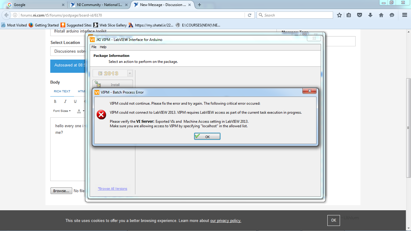

hello every one i want to install arduino interface toolkit but when i do this through vipm i face to this error any one cane help me?

Labview->Tools->Options->VI Server->Machine Access-> add 127.0.0.1 or/and localhost then retry
Edit: Also make sure Allow access is enabled.
