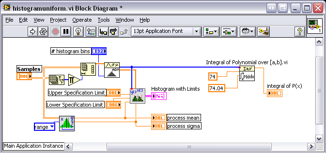

Hello:  How to integrate a histogram between two limits while the program is running?
In attachment I included a simple program that generates a histogram for a uniform distribution with limits between (0 a 1) How to evaluate the area between x and y where 0<x<y<1?

You should be able to use Integral of Polynomial over[a,b] VI to calculate the integral under the curve.
I've modified one of the shipping examples from labVIEW Histogram Example to calculate the area under the curve.
Hope this helps.

Thank you very much.  I will try it.  I forgot to say that I have LabVIEW 8.0
