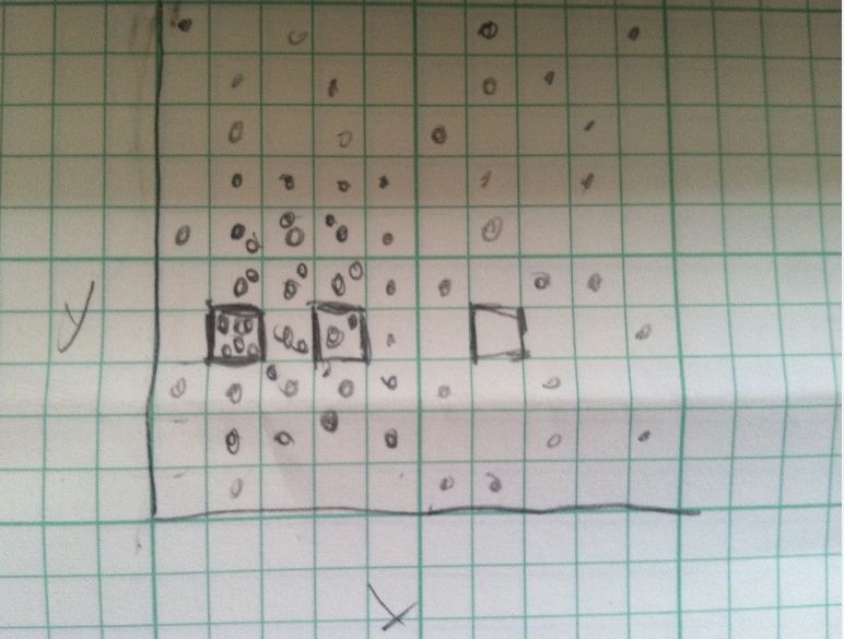

I think I can explain this a little more clearly. Let's say I have a ten by ten scatter plot, And I wanted to focus on a one by one area to test. I want to know when I have 10 points in that one by one square so I know that I have enough data.

Can you explain it graphically?
I don't know what you mean by "scatter plot", "one by one area", "points", and how it all fits together in your particular problem. Thanks.
Are you trying to do a 2d histogram?

So if I had a plot like this, I would like to know when each square fills up with a set amount of points. For the testing that I'm doing it would be really helpful to have a visual of when each area has enough useable data so I can stop testing that area and get more data in the empty areas. If you look at the squares I have "highlighted" the one on the left would be full, the one in the middle would be close, and the one on the right would be empty. It would be really helpfull to have an intensity plot of the same size that shows what areas have enough data, and which ones do not.

Keep a second integer array of the same dimension in a second shift register and increment the corresponding element by one whenever a point is added.

Here's a quick example that keep track of the counts in each bin. You could do a comparison on the 2D array (e.g. >10) and convert the resulting boolean array to (0,1) for a simple "sufficient/not sufficient" indicator. See attached (LabVIEW 8.5)
