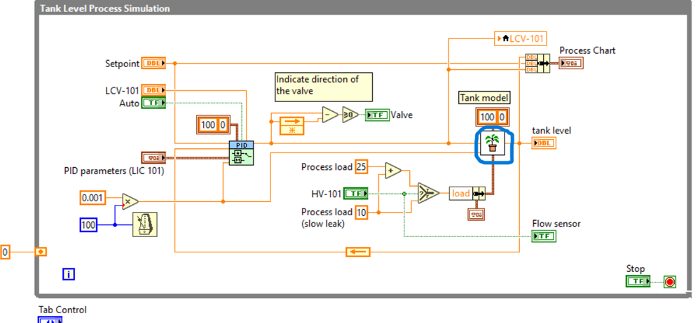

I'm new to Labview, may I know how to make a flower symbol like the one I marked and can the simulation I make not use the pid?

You can edit the icon of your subVI to anything you want.
(Assuming you made the subVI. Look at the help for the icon editor)
(2,277 Views)
Double clicking (with the left mouse button) the icon in the upper right corner of the front panel will open the icon editor, which will enable you to edit the icon to whatever you wish to draw (assuming, as pointed out previously, you have permission to edit the VI for which you'd like to change the icon).
