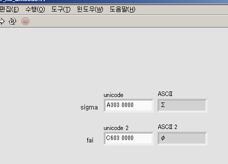

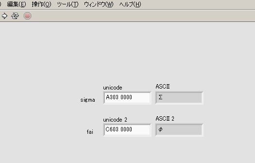

I want to display the symbols "Σ" and "φ" in Japanese, Korean, and English environments.
However, when displayed on a character display, it is displayed in a Japanese environment, but the characters are garbled in other environments.

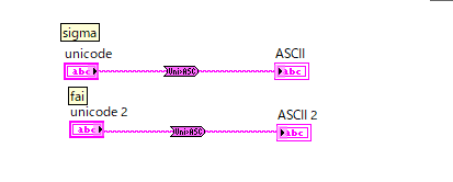

Next, I tried the method of inputting a string in hexadecimal, inputting it in unicode, converting it to ascii, and displaying it in the string display.

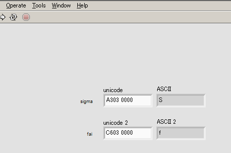

As a result, it was displayed correctly in the Japanese and Korean environments, but not in the English environment.
Is there a way to display it in the English environment as well?
The program that converts from unicode to ascii is based on the following page.
https://forums.ni.com/t5/Reference-Design-Content/LabVIEW-Unicode-Programming-Tools/ta-p/3493021

Converting the Sigma to ASCII results in "S". So everything is ok with your program...
You need to enable Unicode for labview and for the indicator. Then you can write the 2 unicode bytes 0xA303 to the indicator.
Whats the reason for the additional 2 bytes (0x0000)?

I didn't know that sigma converts to ASCII and becomes "S". Thank you.
