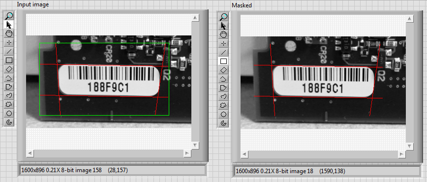

And here is the result of the lines
Green line is the area of ROI selected by the user, while the red lines are the edges selected by the LabView.
(3,722 Views)
And my desired output is the region within the red lines will be cropped out for further processing...
but at the Imaq convert roi to mask.vi, the error of "Invalid type of ROI" has occured.
