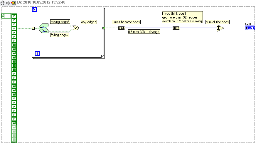

If you only care about actual transitions and not the type of them, I'm a fan of the simple XOR.
GCentral
Message 6 of 8

Accepted by topic author gtathatos
Yes I have tested the one before now I have tested it I guess this should work. Check it.

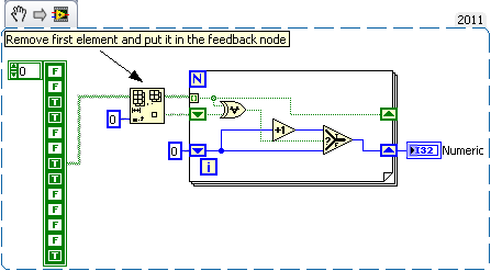

Quite simple.
Norbert
EDIT: Hehe, just seen that it is indeed very comparable to crossrulz' approach 😉
EDIT 2: Adding improved example
Norbert
