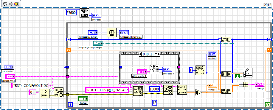

How can I convert a code wrote in labview 6i to labview 2011 format. When I run it, it's not running in labview 2011. So please me to convert it to labview 2011. I'am attaching the code wrote in labview 6i
First of all, this is a new question and has nothing to do with installing LabVIEW 2012 64bit under windows XP, so please start a new thread elsewhere.
This is also not a conversion question, because, according to the compatibility matrix, LabVIEW 2011 can open LabVIEW 6i VIs without problems. If you get errors running under 2011, it means that you are missing a driver, module, or toolkit, or are having programming or configuration mistakes. Maybe errors are exposed because your new computer is much faster than your old computer.
OK, I am looking at your code now and it does not look very expertly programmed, with uninitialized shift registers, wires flowing in all directions, and arrays growing without bounds. Maybe you need a small wait between serial write and serial read? (same for the GPIB IO). Maybe you should only append data to your array if data has actually arrived? Maybe you should not append to file with every iteration, even if no data has arrived? Maybe you should handle errors more?
Who wrote this program? What is it supposed to do? As a first step, you probably should replace all your old serial functions with the modern VISA tools.
What is the meaning of "it's not running"? That can mean many things! Is the run arrow broken or not? If it is broken, what does it tell you if you press it? If it is not broken, are all controls configured correctly before you run (e.g. file path, address string, wait, port number, etc.)?Is the GPIB instrument connected? Is the serial instrument connected? Do you get any errors? Your loop termination boolean is switch action, so make sure it is ON when you start the program.

This one is interesting!
@ OP first after opening your code in LabVIEW 2012 I pressed Ctrl+U. (Albeit with My custom non-default config settings [By george I think I've found it])
A few things jump right out:
  • The "dead code" 12 constant
  • The wrong mechanical action of "Boolean" (replace it with "latch when released" ar just a "Stop" button that has that default MA and invert the stop condition of the loop)
  • the USRs that Altenbach mentioned (Just right click create constant on them to initialize with empty arrays)
  • The lack of data dependancy between the loop that uses the serial port and the initialize serial port code (Do something to enforec that the port is initialized before the loop starts
  • no delay between serial write and read so you are almost always going to read 0 bytes of response to the last write because that is what is at the port (the remote device might not have even gotten the written data yet when you request the number of bytes at port) Move the time delay into the sequence between write and get bytes at port
OP it is safe to ignore the info below just thinking out loud for others..........
Here is one case where the optomizer may have exposed a fatal code flaw that might have been previously overlooked.  (Hmmm. looking at Z order [ in the past the LabVIEW compiler could be tricked into working from back to front but I digress....] the init serial port is in front of the loop and the stacked sequence is behind the GPIB write constant... {really nuking it out the optomizer would have migrated that string constant and flow would change}.)
