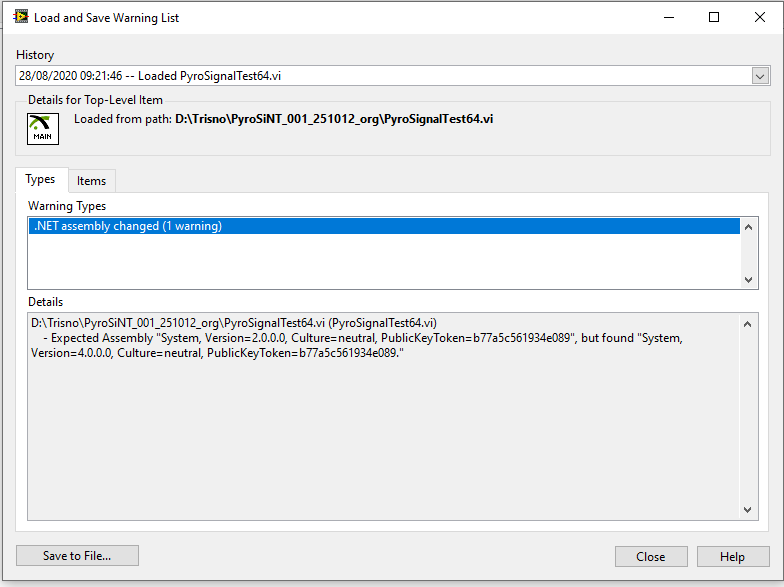

issue Load and Save warning
Hi, master..
Please help me for issue..
what the solution for this problem??
Thankyou..

Hi Trisno,
This isn't necessarily a problem - it's telling you that a .NET assembly installed on the computer you're opening this on is a newer version than was expected.
If you save the concerned file (PyroSignalTest64.vi), then it won't appear again.
These warnings are useful because you might not want the newer version, in which case this tells you it has been loaded, and you can go check that and perhaps reinstall the older version etc.
If you don't have any specific need for version 2.0.0, you can probably use version 4.00 without worrying about it any further.

Hi Trisno,
Which problem?
This is just a warning about using a more recent version of the requested .NET component…
