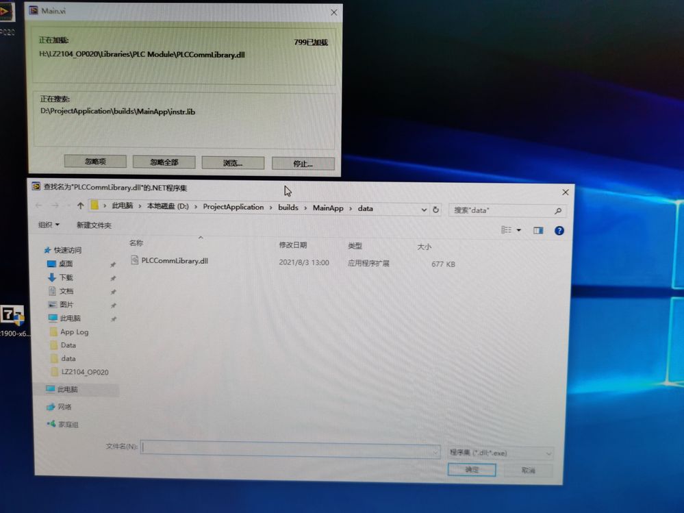

we use a .net dll in the project, it works fine in develop environment.
after built into application, the application popup a diaglog to select the dll, means it can't load this dll in the data folder automatically.

thanks for the reply.

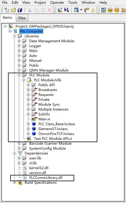

but this .net assembly (PLCCommLibrary.dll displayed in dependency) has no other dependency. this is a single, stand-alone assembly, we have used this dll in different projects, no problem at all. In all projects we used, this dll is located in the \data folder generated by the build process.
the difference between this new project and the ones we used before is, we use classes to load specific instance, similar to HAL, but the base class and all specific classes(here the SiemensS7 and OmronFinsTCP) are all loaded statically, i think there is no path issues.

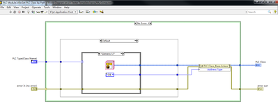

it's done, the issue is solved.
we just place one constructor node of this assembly on the block diagram of the plc base class.
then all things works fine. don't know why. maybe the method of loading classes, but all classes are loaded static.

Glad you solved it but your last three messages contain none or bad information.
The first two are just empty claims without any useful informations as to what you really did nor what doesn’t still works. Putting the sources on the computer?Which sources? Did you write this assembly yourself?
And inthe last you talk about adding a constructor node on the diagram but there is nowhere a constructor node on the image you show. Also you claim that all classes in the assembly are static but if that was the case you couldn’t use a constructor node since LabVIEW would have nothing in the assembly that could be instantiated.
