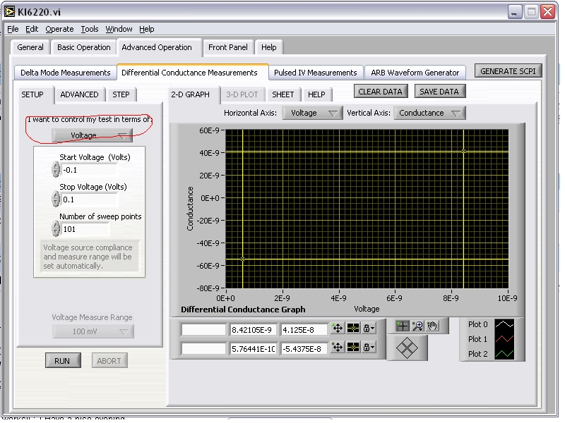

I am trying to use the "differential conductance mode" in software "KI6220.vi" to measure the conductance. In my case, I need to plot a 3-D graph which has source-drain voltage (X), gate voltage (Y) and conductance (Z). So I need to take a sweep in terms of VOLTAGE for source-drain bias. Then the program began to do "auto-test sequence running" but ended with a table saying it could not do it (please see my attached pics). This voltage sweep function works fine over a resistor, but not over a transistor. Appreciates for any advices.

Since this is an executable and I am unable to view the Block Diagram, I cannot troubleshoot the code.  I tried running the program in "Demo mode" with your same settings, and the run was successful, without throwing a warning.  At this point, you may want to contact Keithley.  Nitad5448's comment concerning the 6221/2182's ability to set up a transistor measurement may need to be looked into.  As it says in the warning message, you may also want to check the connections of your transistor and verify that it is enough signal to be measured.  I noticed you selected 0 A for both the current start and stop values.  This may be the source of the warning; the sweep is starting and stopping at 0 A.

The problem happened when I chose the sweep in terms of voltage rather than current. Are you able to take a voltage sweep on a transistor? Thanks.
