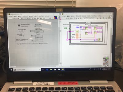

Thank you for your reply.I have been to the site.What does this mean?

Hi Yuto,
Your image shows a DELL company laptop with a sticker on the webcam.
On the screen of the laptop a VI is shown with frontpanel and block diagram…
Spoiler
The block diagram uses some older functions, which I don't recommend to use for GPIB communication anymore. Try to replace the communication part using VISA functions…
You also shold simplify the string formatting using FormatIntoString. And you should implement some error handling as well!

Hi GerdW,
thank you for your quick reply.
I don't know what the block diagram can control.
could you tell me?
yuto
Message 6 of 9
(3,338 Views)
Hi Yuto,
you surely can read the same labels/comments in that image like I do!
The VI will set a source (current) with a voltage limit and a dwell (time) - the K220 is a current source!
The manual of your K220 device will also explain the I, V and W command, which can be read in the string constants. Did you read that manual?
