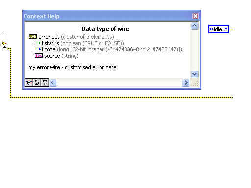

i am not sure what you need, but this might help:
you can always label a wire. either by just overwriting some documentation on the wire (i use white box without frame, >wire name>), or even better, by adding description to your wires (right click on the wire, description and tip). then, whenever your mouse tool is on wire, you will see the description of this wire as you entered!
