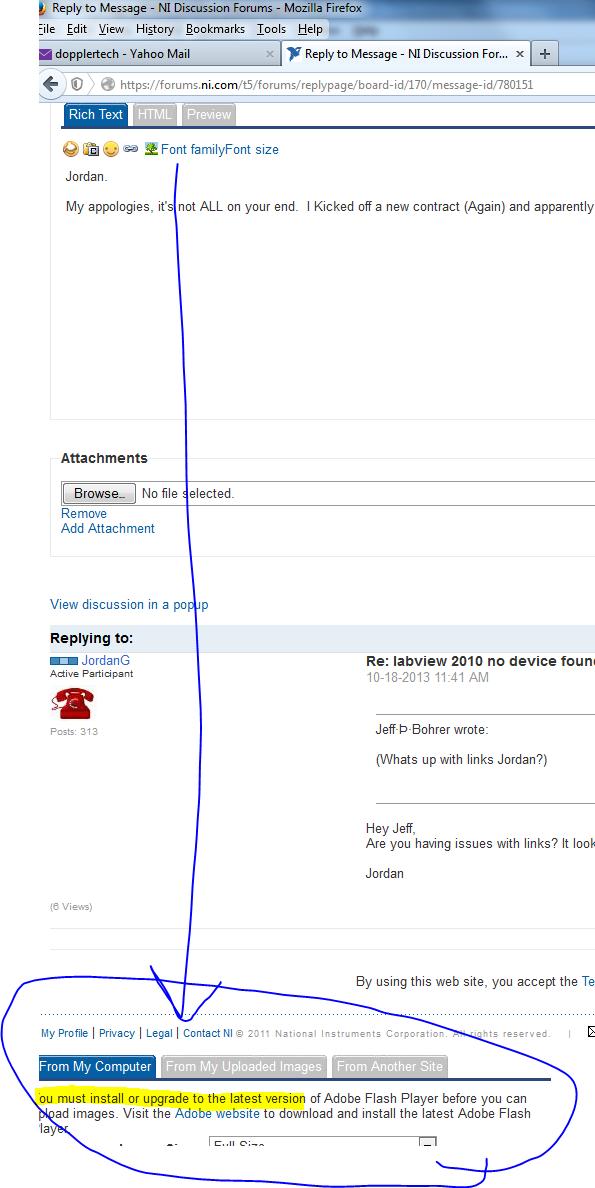

Jordan.
My appologies, it's not ALL on your end.  I Kicked off a new contract (Again) and apparently don't have the latest and greatest flash player.  Of course, if the warning didn't show up Way Way Down off the screen
it would be easier to find
Message 7 of 9
(3,674 Views)
But, I'm all better now.  Sorry to hijack the thread.  Jordan, Feel free to blow off the noisy posts after you see what I mean so Li can work on it.Smiley Wink
