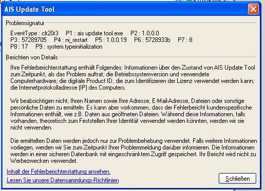

I've created a .net 2.0 application which uses a dll (.net interop assembly) created by LV2015.
I've setup LV to create .net 2.0 DLLs.
Calling the DLLs Functions works fine under the development system (Windows 7 Enterprise).
When I test my application under Windows Virtual PC XP Mode (SP3, .net2.0 installed) the app crashes when it first calls one of the LV DLLs Functions.
The Error is: System.TypeInitialization  ...see Screenshot.
The Function is
                NI_Restart.GetSystemStatus(this.str_IP, this.Username_str, this.Password_str, out status_str, out error_b, out error_i);
(its german, sorry!)
I have made other DLLs (much more Complex) with LV2014. They run fine under Windows XP.
I have included the whole project for you.
I don't know if its about the build configuration. Is it a problem with LV2015?

Simorgh, I'd be more interested in solating where the problem exists here.  You said you've done the same thing in 2014.  Do you still have access to 2014?  If so, save the code for an older version and create the DLL in 2014.  Do you get the same error?  If so, it's not 2015 that's the problem.  It's something in the DLL itself.  We can troubleshoot from there.  If 2015 does cause a problem, I'd suggest opening a ticket with NI and asking them to take a look at a potential bug.

What I discovered in the meantime is, that if I install LabView RunTime Engine 2015 and NI System Configuration RunTime on the Windows XP SP3 System, the DLL executes without error.
I know, the RunTime engines are an official prerequisite for these builds to work BUT I had previous builds which where not dependent upon the RunTime engine (I'm still using the same libraries in the project, i.e. NI System Configuration VIs like restart.vi).
Now, another question is: Is it possibly to eliminate those depencies by build config options or can I include the dependencies in my build?
