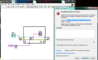

labview Access violation (0xC0000005) at EIP=0x05CD4BBC
Hi, wen im run the vi it clos immediactly and it give me this error
"labview Access violation (0xC0000005) at EIP=0x05CD4BBC"
i have try t reinstall imaq - vision assiant - vision aquisition
but the prolem isn't solved..

How do you exit the application?
You are connecting "FALSE" constant to While loop stop condition so,
I guess you use "Abort" button.
If so, no memory is freed correctly and the crash would be.
Use Stop button.

Ok the strutture of the vi isnt corretti, but I think the problem of crash is the vision acquisition, and imaq file.. i tryed to reinstall but the problema isnt solvend.
 Pls help me, of i dont solved the last solution is format windows
(5,210 Views)
Accepted by topic author Diell.it
for those of you who have the same problem:
I have uninstalled labview with all the expansions, and then reinstall it.
the crash is solved
