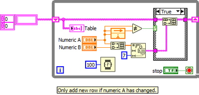

It seems you probably want to prevent the array from filling with millions of rows per second (because you loop has no wait!) and there are much better ways to do that (e.g. an event structure as mentioned).
Still if you want to keep polling, here's a simple draft. Yes there are better ways to solve your problem once you define the problem better. 😉 You also need to decide if the values entered before running should be added or not (hint: initialize the feedback node with e.g. NaN)

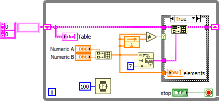

Please do NOT attach a VI with the same name as my attachment. If you modify a VI, give it a new name!
If you want to make sure that both values have changed before adding a row, just do the checking on the array. Much less code. (make sure to set the comparison mode to "compare aggregates"). You could even make the control an array with two elements. Now you don't need to change the code, even if you want five controls in the future!
If you place indicator terminals inside case structures you need to ensure that they don't contain stale data from the previous run. You can set "VI options...execution...clear indicator when called" To make sure they don't retain stale data. My solution was to place the table terminal before the case structure. This way it is guaranteed to clear when the VI is run. Why do you think you need to convert to string and back to DBL for the "element" indicators? Just use a 1D array as indicator and wire it to the orange array as in the picture above. Don't overcomplicate things!
Why do you think you also need the "appended array" indicator. Its data is identical to the table, so only one of the two is needed.
