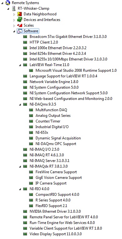

removing SMP did not solve the problem...
i'm attaching below a print-screen from MAX of all the software i installed on my target (after smp was removed).

Just for the sake of answering this old problem (which by the way I experienced).
If you install using the updated USB stick, it will install the updated drivers just for the safe environment. Once you select MAX and you try installing Labview RT 2011 + Veristand RT Engine 2011 it will overwrite everything with the real system, including old 2011 network drivers. The new drivers are available for software install through MAX  on the RT target only if you have LV+Veristand 2012 installed, luckily we have a machine with both 2011 and 2012 suite installed, that way you can install 2011 LV RT + Veristand system and updated 2012 network drivers on your target.
