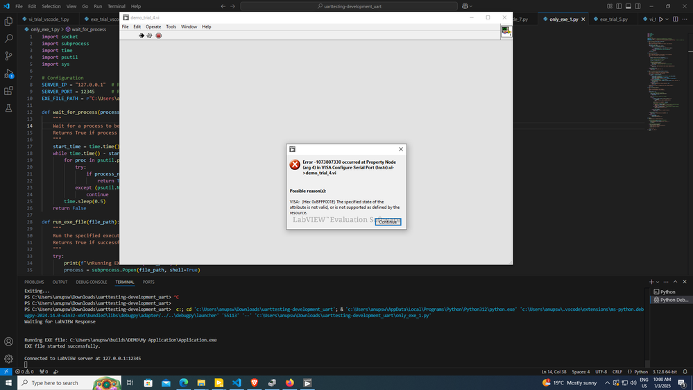

First i converted vi file to exe file ,so i can run automatically the exe file and give input.
I'm sending config data, input data , operation data from python to labview and it is receiving through TCP/IP and writing it in config.ini file and then im opening that config.ini file and read it through readkey.vi block and then it does loopback test on stm32 board.
but im getting error in "visa configure serial port" arg4. I dont understand the data im sending is in proper format.

Is the hardware you're trying to communicate with turned on?
