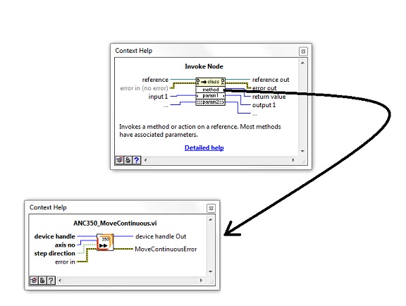

Hello everyone,
I am with a doubt in LabVIEW. Can I put a VI in charge "Invoke Node"? Attached shows an illustration of what I like to do.
Thank
Jefferson

@jfferraz wrote:
Hello everyone,
Thank
Jefferson
This has nothing to do with the earlier topic of this thread and you should have started a new discussion.
It is not clear at all what you want to do. It is not sufficient to show two context help images and an arrow. What does the arrow represent? what is the meaning of "put"? What is the meaning of "in charge"?
