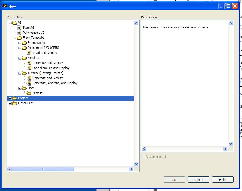

I also am unable to find the DAQmx.vi template.
I am using a trial version (120f3) of LabView 2012 since I am attempting to get an introduction to the software via "Introduction to LabView 8.6 in 6 Hours" as a guide. Exercise 1.2 calls for acquiring a signal with a simulated DAQ device. When I create a VI using the template I created using MAX (Measurement & Automation Explorer), the Exercise instructions indicate I should find it under DAQ Templates - BUT I have no such selection for DAQ Templates and none of the choices in the tree give me the correct option - the attached image shows my choices. Please don't suggest re-installing the software because I have already done that.
Message 8 of 10

I don't think "Introduction to LabVIEW 8.6 in 6 Hours" is compatable with LabVIEW 2012. I'm sure there are some significant differences. I would look toward using another resource to learn LabVIEW. Maybe http://www.ni.com/gettingstarted/labviewbasics/
