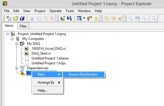

I want to build a standalone application(EXE) using Labview 2015 Evaluation version.
In tutorials, I found that I build a standalone application with evalution.
However, I cannot find the application (EXE) option in the list as shown in picture below.
Would you please help me?

simple answer: your LabVIEW license doesn't allow you to build executables!
How does your LicenseManager look like?

There is your problem.  The Evaluation version does not include the Application Builder.  Give your local NI rep a call and talk to them about purchasing LabVIEW Full or LabVIEW Pro.
