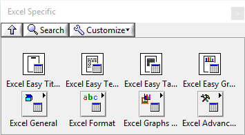

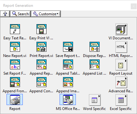

There are several ways to tell if you have the Report Generation Toolkit.  First, look in your Functions and see what you have under Report Generation -- you should see something like the following, and be able to expand Excel Specific.

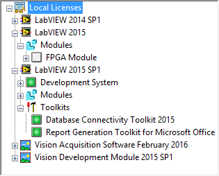

Equally definitive, you can open the NI License Manager (search for it under the Start Button) and see if you are licensed for it.  Note that an activated license look bright green, as shown below.

The folders that you posted from what I presume is your C: drive do look like they are the LabVIEW RGT.  If you have installed it and activated the license, you should be Good to Go.  You'll see Function Palette entries like the first two images I posted, and should see an activated License if you open your License Manager.  You should then be able to run the Example I suggested, as well as the other one you found.
