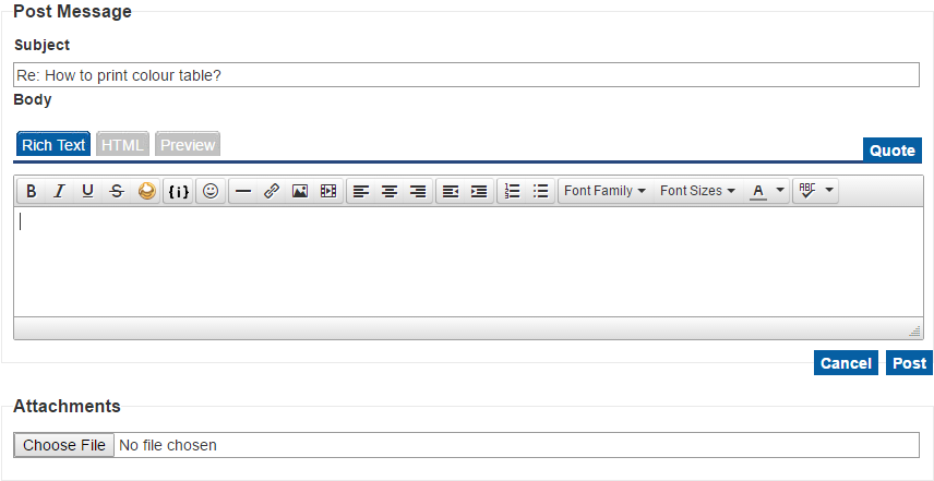

You need to attach a VI.  When you reply to this post, you'll see a picture like this:
Write your response, click on the "Choose File" button at the bottom, then select the VI that you want to attach, (the VI whose picture you showed).  We can't edit or execute pictures -- we need to work with VIs.
