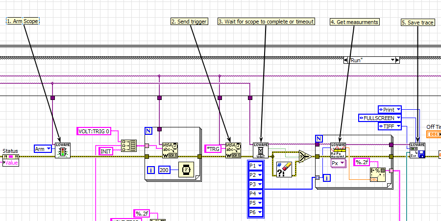

Here is what I do. I am just going to show some screen grabs of my program.

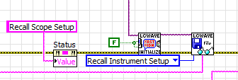

It's kind of cheating but is saves a lot of work. Set up the scope exactly as you need it. (Single, Time/div, Volts/div. etc) and save that setup.
Then use LabVIEW to recall that setup
Then you have to:
  1. ARM the trigger
  2. You may be able to skip this step, but I also trigger a transient on an AC power source at the same time so I send out a 488.2 trigger command
  3. Wait for the scope to complete acquisition
  4. Get any measurements and save them to a separate measurement file (again you may skip this step)
  5. Save the scope trace to a file.
