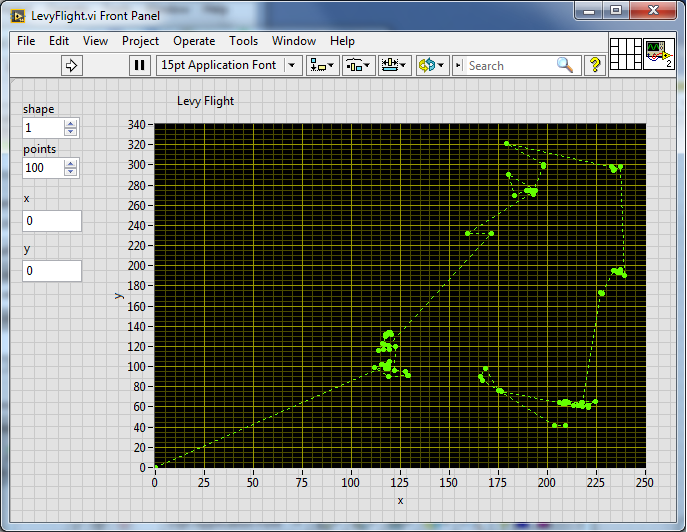

What I am trying to do is to draw the following plot.
It start by choosing a random coordinates (x,y) for a point in the 2D space and then apply the Levy flight distribution for the random walk(step) to move the point in the space.

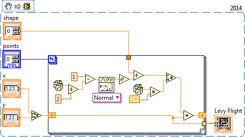

Seemed like something fun to try (one of the few remaining sections in Mandlebrot's book that I have not yet recreated), I use the Inv-Normal Distribution instead of the Inv-Gamma to get the Levy distributed steps.  Choose a random angle between 0 and 2pi along with Levy distributed step length.
