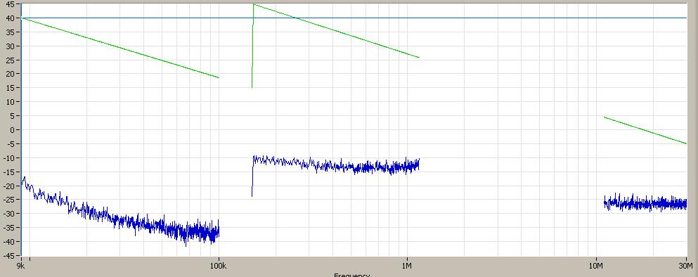

I've got a problem with my XY graph. Here it is :
-My acquisition is realised over several frequency bands, each band is merged to the graph. It works perfectly like there :
18009iE30E7599791400E3
Here I made the acquisition on 4 bands : 50k-100k; 100k-150k, 150k-1,15M and 1,15M-11M.

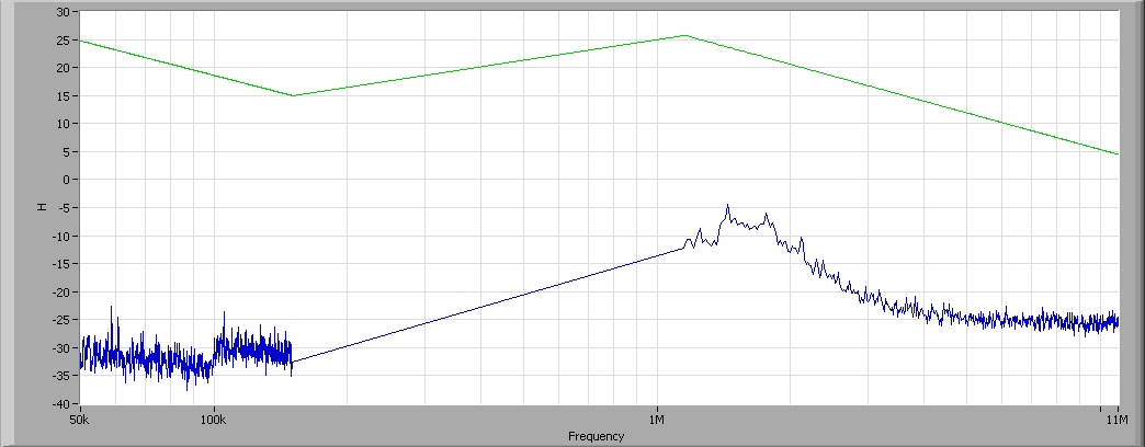

But here is the same acquisition without the 150k-1,15M
18011i49BE2021B637131C
You can see the lines in this band. How can I avoid them? (they are also there when I go from a high frequency band to a low frequency band, and it looks horrible).

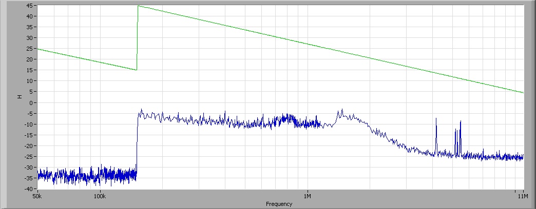

Great ! it works18043iF5FD089FF6086D2E

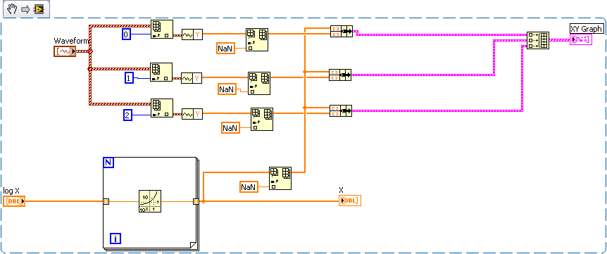

Just added NaN at the end of each part measurement
18045i8D876D755F1B7114
Thanks again!
