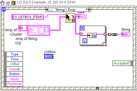

Register for the 'drop' event on a control, the drag and drop data will have info, here's a sample VI. make sure you allow dragging from the Listbox.
The help is very specific on the actual data type in the info. However it's hard to understand:
LV_LISTBOX_ITEMS Array of a cluster that contains an array of strings in the item you are dragging (in order from left to right) and an integer that represents the glyph index associated with the item from which you are dragging data.
