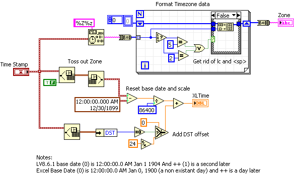

nas1,
This is a shot of the code I use to convert to spreadsheet time format.  Excel can display this number by formatting the cell as time in any format.  It gives you the added benefit that calculations can be done in Excel (such as, get elapsed time, or ,create a graph vs. time,) You can't do that from text.  Lotus uses the same epoch (start date) and scale as Excel but, I haven't used it so I don't know if the calculations work there.  They should.
