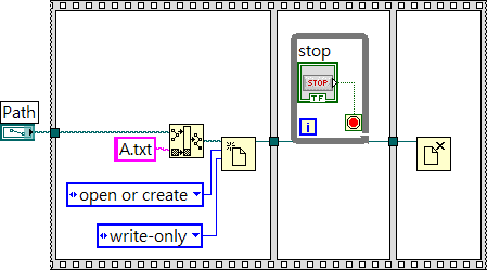

By the second idea, I try the following code but doesn't work.
In one code, I try to create a file and hold for long time
In another code, I try to open the same file in OPEN mode but no error comes out
Thanks.

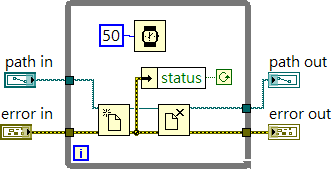

Hi PKIM,
Please find the attached vi.
I've opened simple text file with notepad and tried to open in write and read/write both modes, i got the error.Adding the screenshot also.
uday
Message 4 of 11
(4,904 Views)

Hi PKIM,
Apologies for the mistake.Yes the error was due to strip path in that code.
I was able to reproduce the error with some effort. I got the file open error when it is opened with specific third part applications.
Instead of Notepad,tried to open with Microsft word, labview code is throwing an error.but when it's opened by normal notepad it didn't show any error.
I think it'll depend on the third party app which is using the file. can i know which other app it's using(Curious)
For the labview error code, it's sure that when error 5 occurs, it's file already open.

Ref : http://zone.ni.com/reference/en-XX/help/371361K-01/lverror/misc_lv_error_codes/
Thanks for your reply. Honestly, I don't know what application is it since it is not a GUI application, everything was wrapped into a DLL and dispactched to us. But I am trying to reproduce the issue buy writing a testing program with labview and labwindows. I have a labview code to open and write to a file and hold 30sec before closing. Then using your code to test it. It doesn't raise any error.
I also try to write a labwindows code in C to open and write a file for 30 sec, again, your code doesn't return any error.
So I think labview or labwindows is not opening a file exclusively.

Hi PKIM,
For Reproducing the error, please try the following.
-Create a .txt file and open it in Microsoft word.
-Now try to open the file with the code i've given.
-you should be getting an error code-5 now.
-close the word, and try re-run the code.the code shouldn't give any error.
If u want to block other apps to write to the same file, please use appropriate mode in deny access vi, and after closing the refnum, the access should be revoked.
uday
