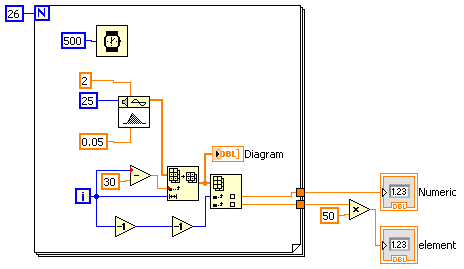

Hi Adam,
when you're talking about those "element" and "numeric" indicators: they only show values after the loop has finished - due to DATAFLOW!
THINK DATAFLOW!
 You also should learn how/when to use BuildArray nodes as well as IndexArray functions:
This does the same as your VI, I just removed unneeded functions.
I didn't change the behaviour at all as I didn't understand the goal you want to reach with this VI…

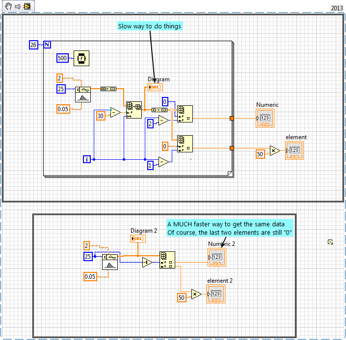

I'm not trying to pick on you but.  for illustative purposes lets try a picture comparing your code with equivalent code that did not run amok through the Rube-Goldberg factory.
Now comes the hard part.  Understanding WHY those two code segments are identical.  The help file and the getting started tutorial will help a lot.
