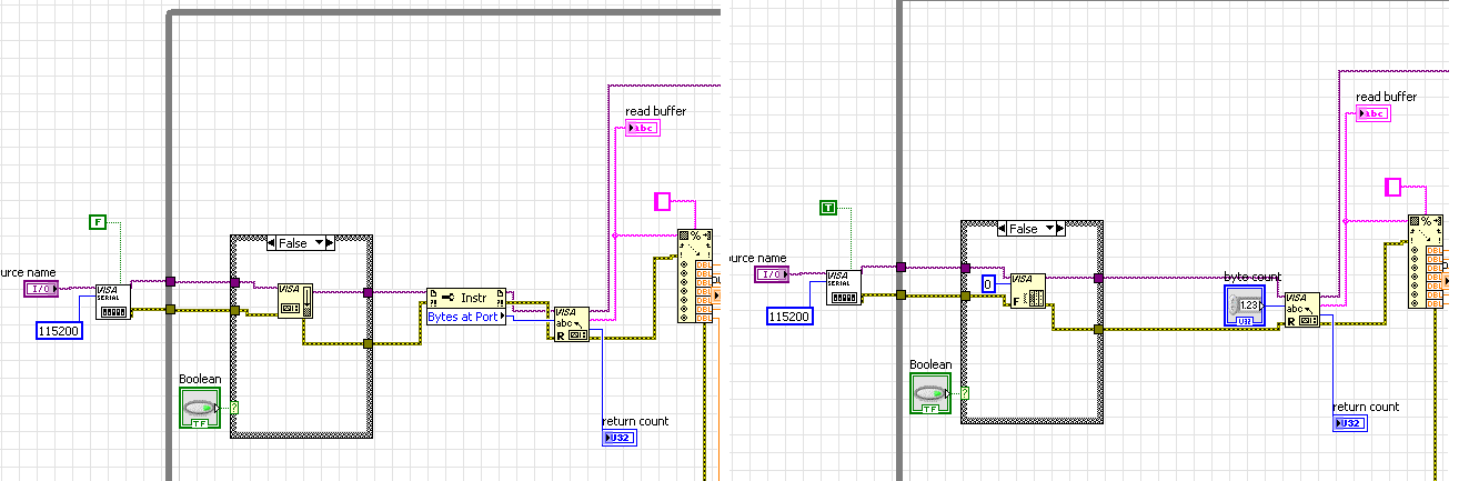

i'm making a datalogger with arduino uno, with 6 analog inputs. the uno sends the data just fine (i use CoolTerm to test). but when im geting the data with labview some bits are lost. i make two VI's, one using "bytes at port" and the other with "byte count". as seen below:

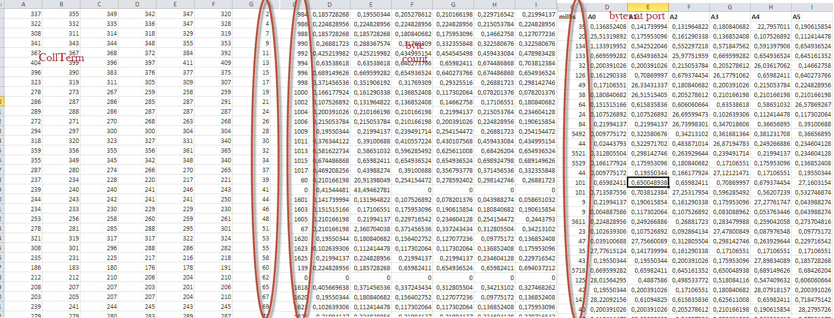

in the next graph i show you the data that reads coolterm and  every VI
you can see the time stamp that arduino is sending, in coolterm is every 2-3 ms, with byte count is 2-3 ms but frequently some data is lost and with bytes at port look like its random.

the case structure is for dismiss the first data in the buffer and to start an pause the acquisition , using a serial flush in bytes at port, dont know why i can't use serial flush with byte count so i use memory free function.
