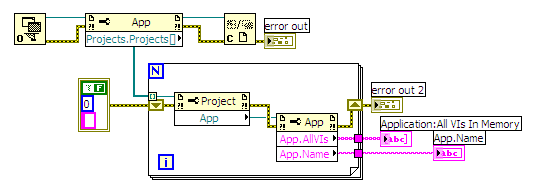

Ok, I found this :
But now how can I access VIs of an running exe through vi server from a VI running appart in LV development system (I mean not as an exe) ??

If I understand correctly you want to connect into the VI server off a running executable from within the LV development envirenment?
More specifically you want to know which VI's are running.
Make sure your firewall is turned off
And use the following code:
Good luck,
iTon
PS make sure you close the APP referenced after you closed the lvproj refs. That was something in your code that might fail. Also have exe's no project envirenment (as far as I know)
