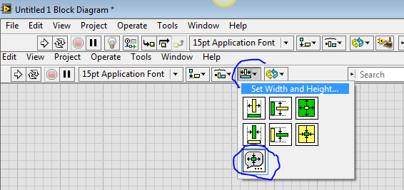

EDIT:  I just realized you might not mean at runtime.  If you want to change the appearance as the program runs use property nodes, but if you just want to set the size select the control then select Set Width and Height from the toolbar.

Look at my Edit from the previous message.  You can simply drag the corners of controls to resize them, then use the Set Width and Height to get it down the right number of pixels.

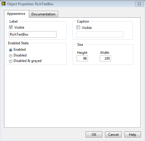

I haven't used ever sucha an old version of LabVIEW but on the properties dalog box?

Looks like I am out of luck with such an old version of LabVIEW.
That property dialog version looks very familiar, and I have been hunting for it but have been unsuccessful.
I don't have the choices shown there in your screen capture.

@nyc_(is_out_of_here) wrote:
I don't see the Set Width or Height options in the toolbar.
The third button to the right of the font dropdown.  Click on that and the bottom button in that drop down brings up the height/width dialog.
