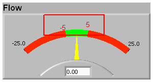

How do I display the text or value on a marker I place on a digital gauge (see picture)

I want to make the text visiable. i.e. +/- 5.  I can move the markers values around.  I want to display what the value is.  I was wondering if there was a property in the control that allowed for this.

  In the attachment i i put the marker spacing as arbitrary and in the scale.markervalues property to values as -25,-5 0,5,25 and  scale.style property to 0..Please check this attachment..

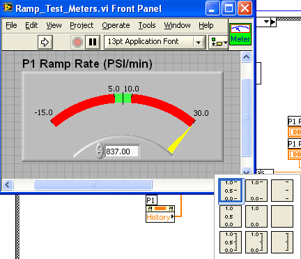

Ok rookie mistake.
Needed to change the scale display settings (see picture)
Thanks for the help!
