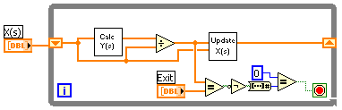

My apologies but I am not exactly sure what you would like to do.  Are you trying to include some sort of feedback to your loop, such as the value of Y/X?  What do you mean write the Y/X?  If you would like to add feedback to your loop, the easiest way would be to use a shift register.  I am assuming that you have some sort of update formula based on Y/X for X, that you could pass to the shift register that would allow the next iteration of the loop to access this information (see below).
This could possibly be implemented in just LabVIEW, but you could certainly do it using a script node.  Repost with some more information and I will be glad to help.

I suppose I could explain the diagram a little better... The input of the application would be your X(s), this is the starting value that is passed to the while loop.  The loop then calculates Y(s) (which is your code), then divides Y(s) by X(s), which gives Y/X.  This is then used to update X(s) (again your code).  The exit condition of the while loop is to see if Y/X is equal to any give array.  Each element is compared, which gives an array of booleans.  Each element is passed through a Not function, and then the entire array is converted to a number.  If the entire array at that point is 0 then that would mean that every element is equal to the exit array.
