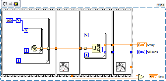

Hi jmountney,
what size is your array?
The LabVIEW compiler is pretty smart about working with autoindexing FOR loops!
This one executes on my laptop in less than 50µs:
(For a 1000×1000 array it takes ~2ms.)

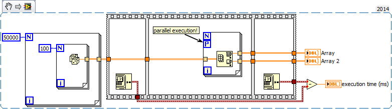

Hi jmountney,
using parallel execution brings execution time from 27ms to 5ms on my 8-core i7:
Does LabVIEW automatically take advantage of multicores?
General answer: Yes.
More specific answer: it helps to have a basic understanding of what the compiler is doing under the hood…
In your example you have a loop with just one function inside. This will manily run on just one core - unless you tell LabVIEW to use more cores as shown!
Message 9 of 14
