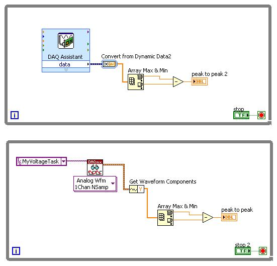

Ravens Fan is spot on with this one, finding the peak to peak of a signal is not too hard at all. If you are using the DAQ Assistant just wire the signal output to the 'Array Max & Min' function and it will automatically insert the convert from dynamic data function for you. If you are using the DAQmx functions you will need a Get Waveforms Componants function or just read the data as an array straight away.
Hope this helps
Rich

Thanks for the code it did the trick alright. But noise is a small bit of problem but i am going to run a loop and sample over a period of time and average the values, this should limit the noise variations of the signal.
