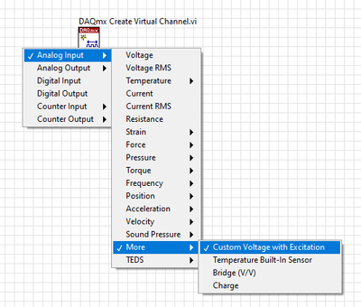

To read the voltage place a DAQmx Create Virtual Channel.vi and configure it for "AI Custom Voltage with Excitation"
It's under
Message 9 of 10
(2,824 Views)
