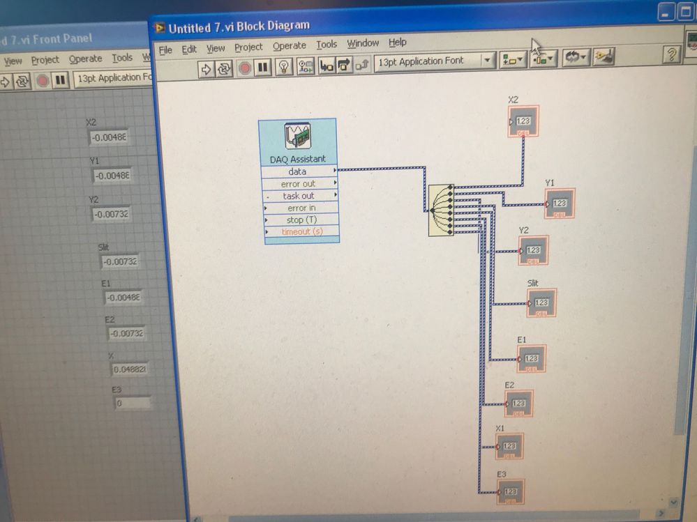

Hi, I'm a new user of LabVIEW. I'm planning to measure voltages of 8 different channels at the same time. The picture above is my program. Just wondering if this program can work? It seems weird.
Could anyone help me please?

What seems weird about it?  It's weird to me that you posted a photo of your code rather than a screenshot (or better yet, the actual code).  Smiley Wink
Anyways, as long as you have the DAQ Assistant setup properly and your hardware supports 8 channels, it should work.  I'm guessing you'll want to acquire data more than once so you'll probably want a loop around that code.

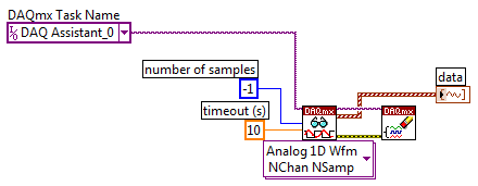

Thanks for your reply. I thought it looks weird because others programs look like this:Example_Code.png
Smiley Tongue  I guess this is the actual code you mentioned?
Thank you!
(2,880 Views)
Yes that is the actual code behind the DAQ Assistant and you would be wise to learn DAQmx that way rather than the assistant.  You can right click the assistant and view the front panel to see the actual code.
