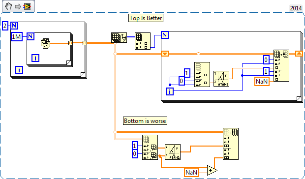

My use case may differ, and by no means am I a programmer or any expert, but I like DVRs for the following reason:
I usually have multiple loops in my application, one that handles instruments, one that handles data, one that handles the UI, etc. When I download large data sets from an instrument, I like to put that data in a DVR, that way I am only sending a reference to the other loops, not a data copy. Within a loop, you are typically correct ...
The simplest LabVIEW code - the one using the minimum necessary number of nodes - is often the most efficient.
Look at the snippet the top case is more complicated but uses less memory in comparison with the bottom case. (Run them separately, I was too lazy to make two snippets)
Cheers,
mcduff

For sharing data between loops, yes, a DVR might make sense, but it's definitely not the only way to share data between loops without making a copy. Queues and functional global variables can accomplish the same goal.
Maybe I over-simplified, but there was a reason I put the "often" qualifier there; I didn't mean to suggest that it's always the case. You do still need to evaluate the logic. Adding NaN may seem like a simple way to turn an entire array into NaN, but initializing an array of the same size to NaN would be better. More importantly, to evaluate the simplicity and effectiveness of this code, we'd need to know what the desired result is. Quite possibly neither of these versions is the best option (if I wanted a 2x1m array where one row is all NaN, I wouldn't do it either of these ways).
Message 24 of 50
(3,041 Views)
Quite true. In this case, the user can look at I & Q data, I^2+Q^2 data, phase, unwrapped phase, or the magnitude of the FFT of the unwrapped phase.
I am using the same buffer over and over, so there are two data rows I & Q directly from a DAQmx device. Sometimes the user wants to plot both I &Q, other times the user wants to see the phase. So in that case, one row becomes a NaN so it is not plotted. The orginal data is not saved so there is no reason to keep it. There is probably a better way though. (In this manner I do not need to reshape my buffer, no do I need to switch to the UI thread to update a plot reference.)
Cheers,
mcduff
