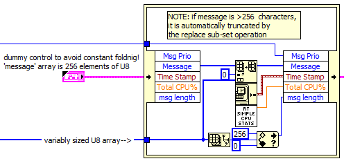

Pretty much nathand, we have. same goal, somewhat different approach.. for some reason I just really can't seem to nail down the whole IPE thing, the more I stare at it and the more I read, the more questions I get.  Every time I feel its clearer though.. maybe this is the time it 'sits' for good.
I do appreciate you taking time (again) to answer and help out with these discussions.
Based on our discussions so far, I'm still not certain about the following diagram (below).  I now understand that since I'm not operating ON the cluster data (except for the 'message array), there is nothing gained by having those cluster value 'updates' inside the IPE, on the other hand, it seems I may as well do it all in the IPE since I have it (no harm?)
What I'm not sure on is, based on your previous points about replace array element, is if there is even a point in using the IPE at all here?  -On the one hand, I'm operating on a data array in the cluster (one of the IPE text book use-cases?), on the other hand I might just as well do the same operation by means of a single "Bundle by name".   Note that the cluster control is a dummy control to prevent constant folding.

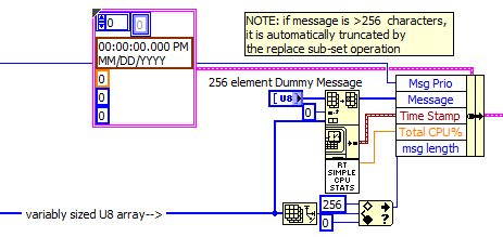

OR I could just do this, but would that re-use the memory without invoking the memory manager or not? no ipe.png

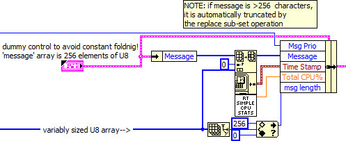

OR since the above will (supposedly) duplicate the whole cluster, perhaps this way (note cluster constant now has empty array): no ipe w array.png?

Personally I'd recommend the simpler, and more readable, "reshape array" to 256 elements. All three of your versions currently have an unnecessary 256-element control in them, of which a copy needs to be maintained because it's not changed, so you're not saving yourself much versus a constant. Let's say you had the front panel of the VI open - then it's obvious that the code has to make a copy of the 256-element array, because the copy that's displayed on the front panel doesn't change. When the front panel is closed, LabVIEW can use the front-panel data directly without making a copy, but that array still needs to get reinitialized to its default value on the next call (and again, it's copying data that's slow, not the memory allocation), and the array value is stored with the VI. Take a look at the buffer allocations (note, I haven't recreated this to check so I don't know exactly what it will show, but I'm curious). Reshape array avoids storing an array anywhere.
Depending on the source of that message array and its typical length, there might be better alternatives.
There's no harm, but also no advantage, in an IPE here. It will work just like a typical bundle except it takes up more diagram space. I recommend your third version, but with reshape array instead of replace array subset.
One other very minor optimization would be to replace In Range and Coerce with Max & Min, since an array size will never be less than 0. For that matter, if you can accept the array having less than 256 elements (but not more), then you could wire the Max&Min output to the reshape array size. Shrinking an array or keeping it at the same length won't result in a new buffer allocation, so you'll save yourself any copy there.
Message 35 of 50
(3,362 Views)
