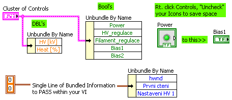

Bundle your data lines for cleaner look and change your Icons...
and right click on your "Teplota">>Visible Items>>check "Digital Display"...no need to add another "dig display" at the lower left of it
Again, no need for 2x "Event Structures" within your while loop....I do not understand your reasoning for using multiple "Wait(ms)". Check out LabVIEW 101
