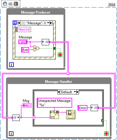

Here is a Very Simple Consumer/Producer of "Messages", where the "Message" is just a String ("Command").  Note that there is also something called a Queued Message Handler, where the Message is a Cluster having the "Command" part and a "Data" part -- I've coined (for myself, feel free to "borrow" the term "Channel Message Handler" where Channels replace Queues.
One trick with Channels is that they appear to "break" the "Input on Left, Output on Right, Parallel Loops arranged vertically (suggesting "simultaneity")" Rule, but you'll see how I deal with this.  I'm attaching this as a LabVIEW 2016 Snippet and VI so you'll be able to use it with 2017, but those (like myself) who use LabVIEW 2016 can also "play".
The Message Producer is a simple Event Structure that every time a Message is entered, it is put on a Messenger Channel.  If the Message happens to be "Exit", it exits the loop (and the Message Handler Loop, below it.
The Message Handler gets the Message through an S-shaped Channel that goes down, turns left, goes to the beginning of the Message Handler Loop, and goes in to a Channel Reader.  The Message is displayed and then acted upon using a Case Structure, one Case per Legal Message.  Any "unexpected" Messages (I used "Hello") go to the Default Case that warns of the Unexpected Message, and then generates its own Message, namely "Error".  Since this is a Messenger Channel, I take it out the right side, up, and join it to the Channel coming from the Event Structure, thus allowing the Message Handler to send Messages to itself.  It's not shown here, but what the Error Case does is simply use the Value Signaling Property of Message to send an Exit Message, stopping the Event Loop, and in the Message Handler, the Exit Case also stops the Message Handler.  Finally, there is a Valid Message ("Valid") that is the remaining Case for the Message Handler -- it does nothing, in fact, but if you run the routine and type "Valid", you'll see "Valid" appear in the Msg Indicator.
This is an exceedingly simple demo (believe me, I have more complicated CMH routines), but I hope is illustrates the idea(s) of Messenger Channels.  I use them a lot (more than any other Channel Wire so far).

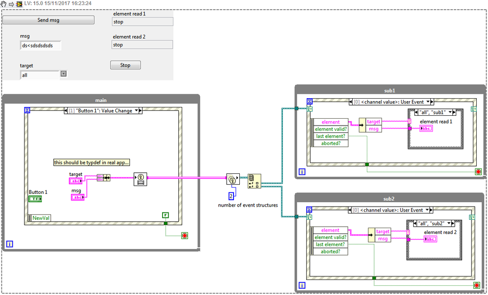

I would like to show you an alternative to Messenger channels. I really like to use Dynamic User Events, and we also got Channel types (Event Messenger Channels) to make programming faster with these useful things!
Note that, I have here in one block diagram 3 Event Structures which is usually not a good idea, so this is only for demonstration purpose!
In my real applications those other Event Structure loops at the right are either inside parallel running subVIs, or in dynamically called VIs (like callable modules which register for Events fired from the Main-vi.
Because you can branch this Channel wire, you can register all Event Structures for these Events, and you can make a kind of label so you will know what is the target loop of the actual msg...
You can extend this example in a way that you can send msgs back to the main Event Structure from any of the "subVIs" or sending msgs between the subVIs.

"This is an exceedingly simple demo (believe me, I have more complicated CMH routines), but I hope is illustrates the idea(s) of Messenger Channels.  I use them a lot (more than any other Channel Wire so far)."
Bob, your example VI is nice and works as you explained. But IMHO the OP does want two separate consumer loops. He thought (me too) that the "many-to-many" expression means we can have multiple writers (as in your example), but also multiple Readers! In your example you read the Channel at a SINGLE place!

No! This is what I thought in the past. But the acknowledge IDs are working in a totally different way. So you cannot "label" msgs to target only a single Reader node. This was just my original wish 🙂
I would like a new Channel type, we could call it "Targeted Messenger Channel", where you can specify a target ID, and only those Channel Readers would get these msgs which has this particular ID specified (even during runtime).
If you have a look at my Event Messenger example above, the real problem with that is EVERY Event structure will react for all sent msgs. Yes, we can ignore msgs not to be handled in the actual loop using a cluster, but this is not too elegant. A "Targeted Messenger Channel" would be much more awesome! 🙂
