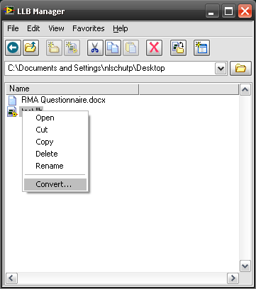

If you want to get the VI's from your LLB, you have to start the LLB Manager from LabVIEW and browse to the LLB file(s).
Than you right click on the LLB file and select convert (see "Select File.PNG").

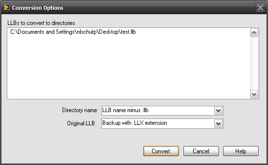

An Conversion Options window will appear like the one in the file "Conversion Options.PNG".
Here you can make some adjustmens, and after clicking on the "Convert" button, the LLB will be converted to a folder with the VI's.
