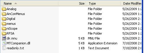

Are you completely closing and opening LabVIEW after completing the install of your toolkit? Once the toolkit is installed LabVIEW will need to close and open again to repopulate its palette. Can you post a screenshot of the files and folders that exist under <LabVIEW>\vi.lib\addons\Modulation after the installation is complete? Do you see the Analog section of the palette in LabVIEW? I am also curious to know what subVIs are missing and if they able to be found if you let LabVIEW search for them upon opening.

Here is a screenshot of the Modulation directory:

Hi Tim,

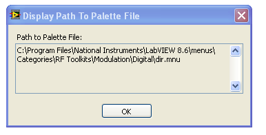

It seems that everything was installed correctly, so I am not sure exactly why this didn't populate automatically. I think we should try manually adding this to the palette. I included a link below which will describe this process in more detail, you will want to reference part 'V. Icons or Palettes Missing'. You will want to add the Digital section to the palette by pointing to the correct .mnu file that is located in the Digital folder. I included an image of where my .mnu file is located as a reference. This should work for you, but please post back and let us know how it goes or if you have questions.
Missing Icons on Functions or Controls Palette in LabVIEW
http://digital.ni.com/public.nsf/allkb/46E1672AB48C917D86256AFE00075436?OpenDocument

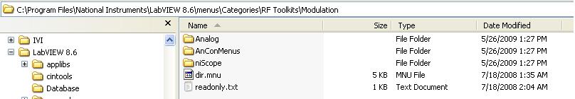

Thanks for the link to the KB article. I was able to successfully add the Digital Modulation subpalettes to the functions and controls palettes. I'm still not sure why it installed incorrectly as all the files were in the correct physical locations. The one thing I did notice is that the Analog palette is pointing to "Program Files\National Instruments\LabVIEW 8.6\menus\Categories\RF Toolkits\Modulation" for it's dir.mnu file. There is an Analog subdirectory within this path but no Digital subdirectory.
