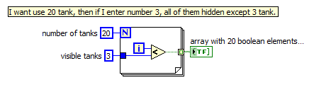

tnx Gerdw, I searched but there is no integer to boolean convertor Icon over there.
I want use 20 tank, then if I enter number 3, all of them hidden except 3 tank. r u sure that is possible? how (pleas clearly)? I cant do with these solutions.

Hi behzad,
when you can't count upto 20 you definitely should go through LabVIEW basics courses! 😄
See this inspiration:

Hi behzad,
for the 3rd time: go through all those FREE ONLINE LabVIEW courses offered by NI!
"TF block" is a boolean array indicator, created by right-clicking the FOR loop output tunnel…
How to "separate each bit" I have told you before: IndexArray!

HI GerdW
I didnt know anything about that kind of courses;
your help was really good. tnx.
TF there is not in my program. I used IndexArray. but I need all 20 bit of boolean array at the same time. IndexArray cant seperate all of them and just get me one bit.

Hi behzad,
now you know…
Use just one IndexArray function! Did I mention this before?
