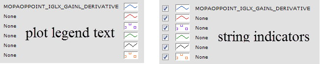

in the plot legend, is there a way to move the text of the individual plot to the right side of the plot box.
my problem is that if the plot name is long it pushes the legend to the right so i have to move the plot legend some distance to the right taking into consideration the longest name that could show up programatically.
so i am using string indicators on the right and not showing the plot legend text at all, but that causes a problem when i want to export the graph to clipboard or excel the plot legend text wont show just the boxes.
any ideas to overcome this or show the string indicators on the export image?

If you want to do something like this, you can create a type def and then drag the plot names to the other side from the type def. You can do this by right clicking on the graph and select "Create TypeDef" and the right click "Open Type Def".
