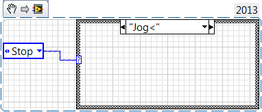

Oh why oh why not use an enum instead of 4 booleans
Message 8 of 12
(4,770 Views)
And how would you translate the four booleans to the 16 enum items? 😄

@altenbach wrote:
Boolean array to number.
Or I'm guessing he is suggesting don't use the 4 booleans and instead use an enum. It is hard to say which would be better without knowing more.
